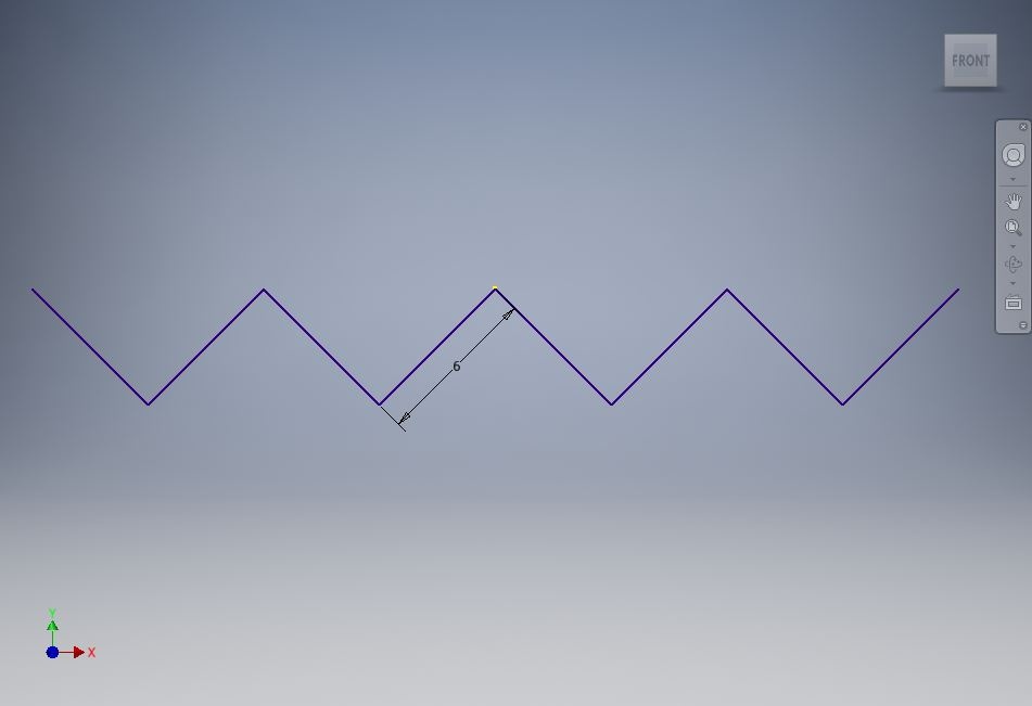

simple sketch in front plane:

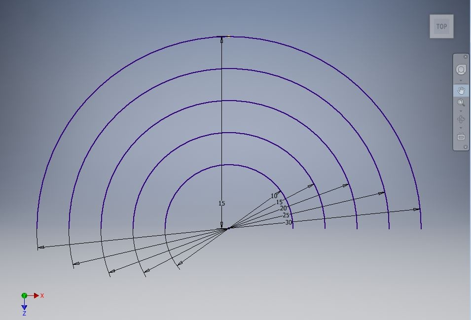

a few concentric circular segments in top plane:

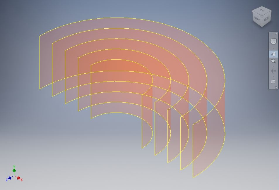

extruded surfaces of the circular segments:

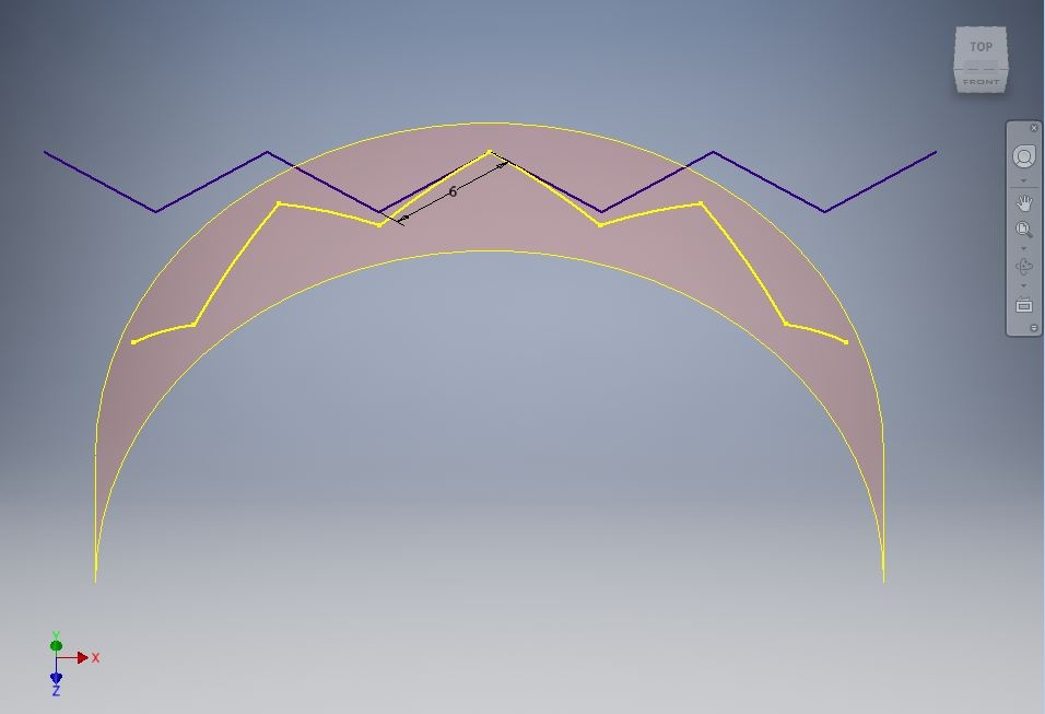

creating a 3d sketch by wrapping the first sketch to the first surface (I need to have the projected line segments 'equal' with equal 'angles' and distance between the points.):

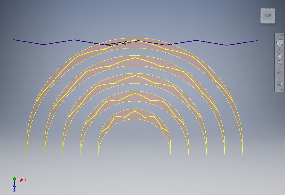

final result - in the same 3d sketch, the first 3d projection is projected 'normal' to the other concentric surfaces:
