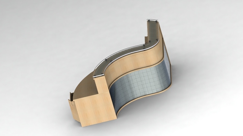

I'm using SW 2014 to create a front desk design but this desk has sort of S-curve shape
Quick sample render below
Now for the front of the design I need to place "tiling" (Thin metal squares with small gaps in between that need to cover the entire front curve)

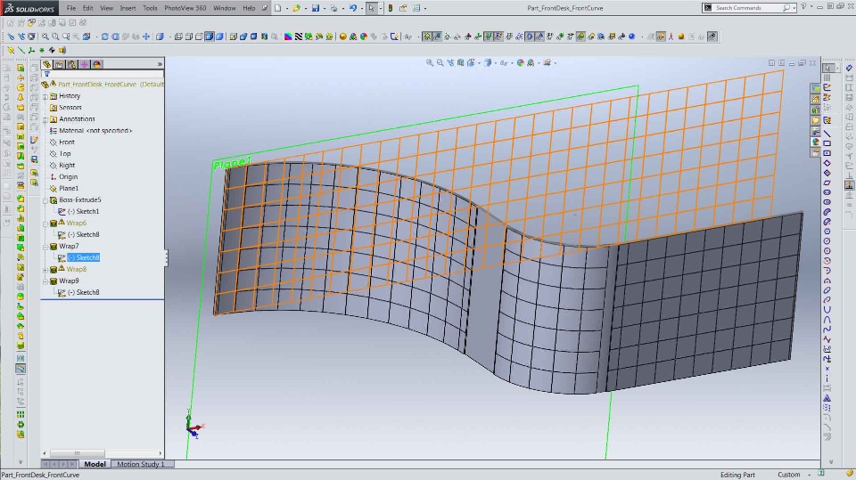

The wrap feature works perfectly except for my exact situation.
Since not all curves (on the front face) face the same plane thus I would need to wrap each part of the curve individually which wouldn't work because then the tiles wouldn't match up.
Image example below showing one "tile" (using the wrap feature)
There is that one face I can't select which means I can't use the wrap feature on the entire to solve my issue (or so I think)

UPDATE 1:
Seems that the wrap feature is the best option but it does the job half way...
Any way I can fix this? (Ref. Part_FrontDesk_FrontCurve_02)
Three sections of a face with no wrap

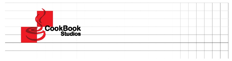

Now the problem is putting the logo ontop of my design
Below is a rough layout of how it's going to look (The tile layout is incorrect)
The "Warm pot steaming" is going to be perspex and same with the logo text (CookBook Studios)
The huge two red blocks behind the steaming pot is not perspex infact its just colored tiles that form the two squares behind the perspex.
There is three different perspex parts the black perspex that forms the text and then the red that forms parts of the "Warm pot steaming" and lastly the rest of the "Warm pot steaming" is a dark red perspex which is going to join with the red perspex.
And again the red blocks are colored tiles behind the perspex (4 tiles create one block)
Attached is .DXF file of logo
and as you can see the logo is to the one side, indicating it's on the longest curve.
