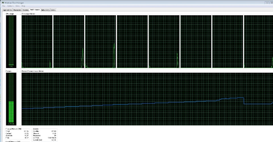

Question:
  • Is there a way to force WPDM to dump any cached data? Can be through the API or a setting somewhere I don't yet know about (probably wishful thinking)
Problem:
  • We are having an issue with memory related crashes when there is high WPDM traffic.
  • WPDM seems to be caching the files until it runs out of memory and crashes the service. Image below shows results of a test run using the API to stress the vault.
