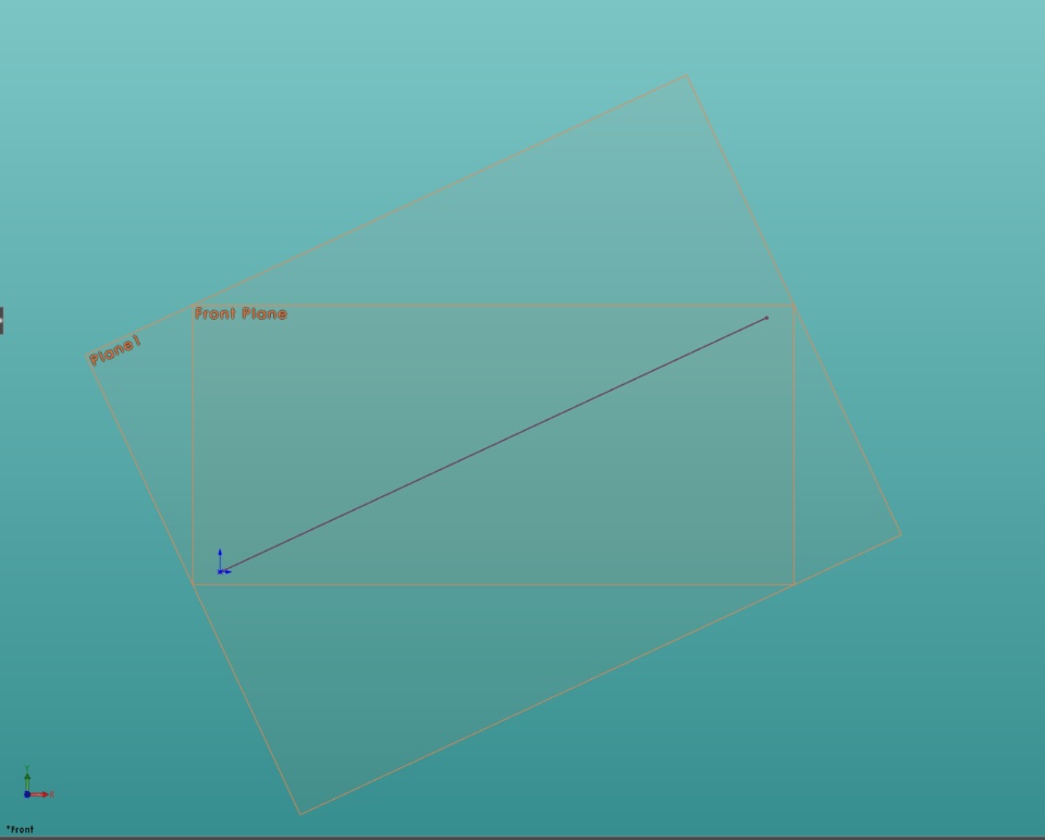

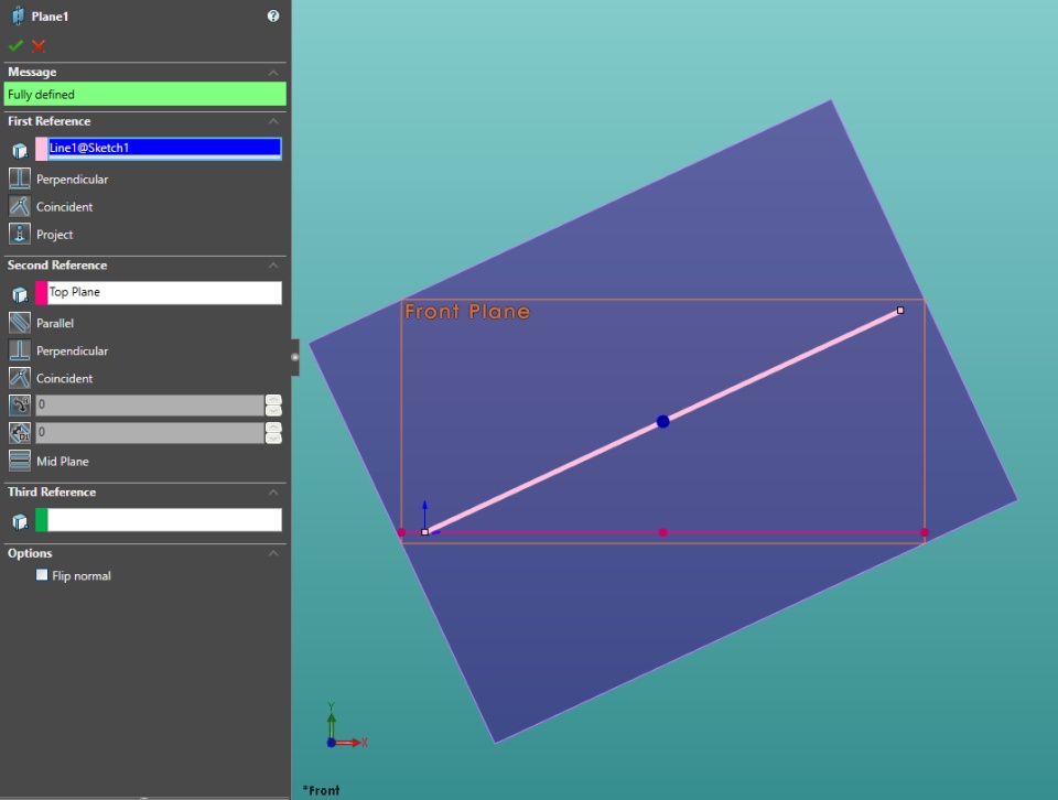

Today I discovered that if you construct the plane such that it is:
  1. coincident to a sketch line and
  2. perpendicular to a plane (or surface) that is not normal to that sketch line
then you'll get a plane whose horizontal direction is the direction of sketch line. If you then sketch on the newly created plane, the "left" side of your sketch will be the side corresponding to the first of the two points involved when you created the sketch line from step 1.
In the picture below, Plane1 is coincident with the Front plane, but is oriented such that the horizontal direction is 25 degrees counter clockwise from the X axis. This plane was created as being coincident to the line in the visible sketch, and perpendicular to the top plane.

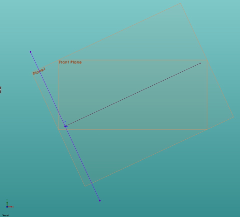

It is necessary that the plane that is used for the perpendicular reference not be itself perpendicular to the sketch line. For example, if rather than use the top (or right) plane for the second construction reference, I use the plane highlighted in blue in this next image, the feature will fail.
