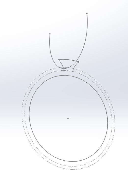

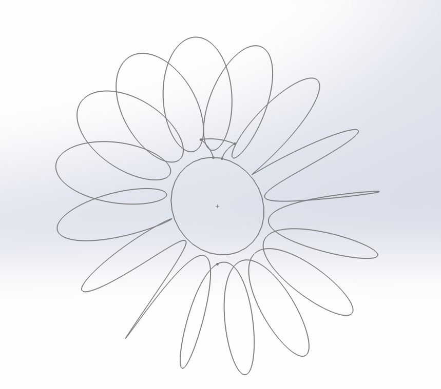

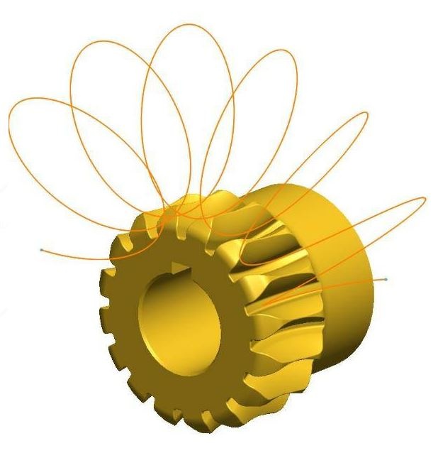

Dear people,
Here it's attached a super macro, creating the path for creation of a worm wheel gear. it also creates the cross section as an involute profile.
It creates global equations, so if you run it twice with different values in same part, it won't overwrite the values, you need to delete the global equations manually before hand.
