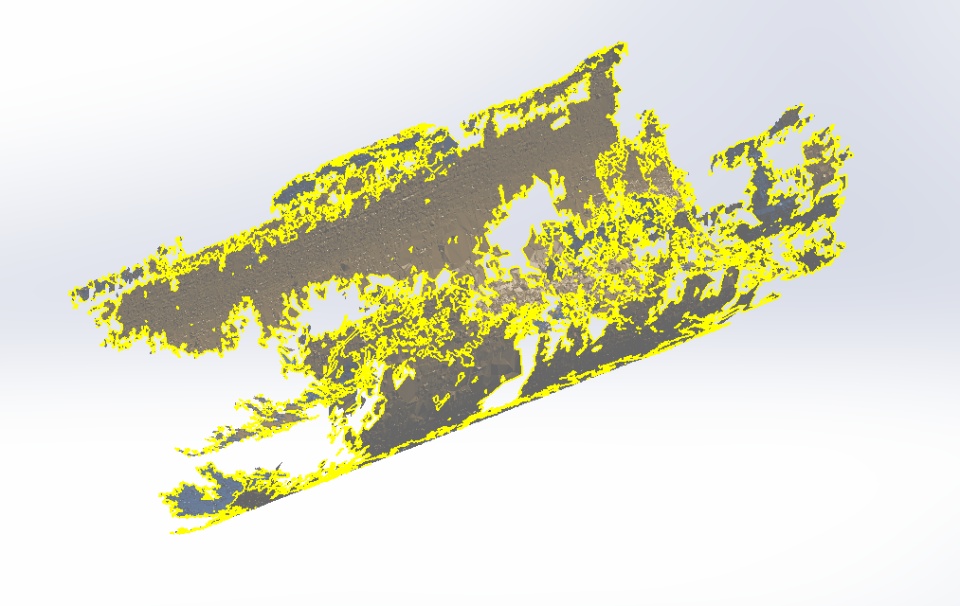

My work recently purchased a scanner for our Faro arm. We scanned a wood piece I brought from home as a test and I am having problems starting off. The scan is a point cloud with roughly 2.2 million points. I have tried using the Scan to 3D wizard with no luck. I have have tried about 10 times with different settings and get about the same results.
Here are two screen shots. One is of the point cloud before the wizard and the other is after. I have also tried to split up the point cloud into smaller sections using meshlab and then opening them with Solidworks; still no luck. Does anybody have any ideas what else I could try?
Thank you for any help you can offer.

After working on this a bit more I have found that if I select the optimize mesh with thin thickness it seems to work better. It is still not a great looking mesh and when I am done I get mesh error. I have to reduce the size to around 100,000 to get it to work.
Last night I let the computer try to construct a mesh with 600,000 points. It was still working on it this morning.

Do you have any software to surface the point cloud first into a triangulated surface, before importing it to SolidWorks?
There appears to be a lot of noise in the scan, which might be why Scan to 3D is having a hard time with it.

I can try to clean it up with Meshlab. We use Polyworks to to do the scan. I will have them try to try some different settings when they do the scan.

Nathan,.. sorry, I don't have scanto3d.. so, I opened this in MeshLab (filtered/surfaced) and exported as a wrl and obj..

Before inserting scan (stl) into SW it is necessary to reduce quantity of triangles (Magics Materialise->; triangel reduction). SW already will open a detail without use of scanto3D.

I worked with this in Geomagic. I could not do any better than the attached without using excessive noise reduction.

Make it easy and fast. 1 min. and go....
Accuracy of geometry is necessary it is necessary to choose the size of triangles less at a triangulation more.
