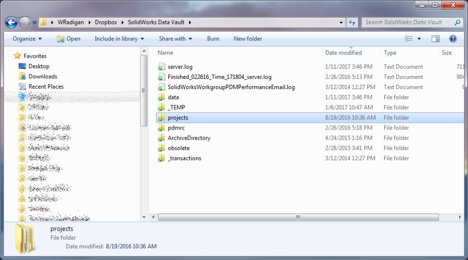

Go to Workgroup Data Vault and the "Projects" subfolder | |

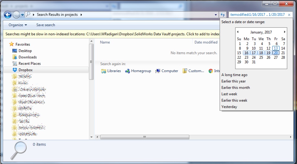

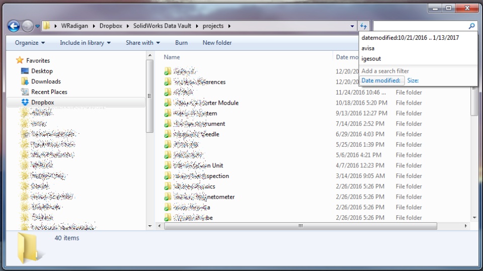

Use the Search box and select "Date Modified"

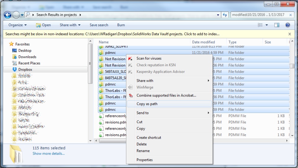

Select all of the Folders in the search results Shift-right click & Select "Copy as Path" | |
