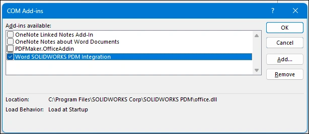

In "Microsoft Word" with add-in "Word SolidWorks PDM Integration" enabled,

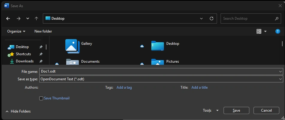

When we tried to run SaveAs command in macro (Word VBA),
Instead of saving as to given path, Word displays Save As window and 4198 Command Failed error in macro.
This only happens with add-in "Word SolidWorks PDM Integration" enabled,
If we disable the add-in then macro executes without error and Save As window not displayed.
