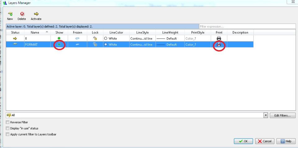

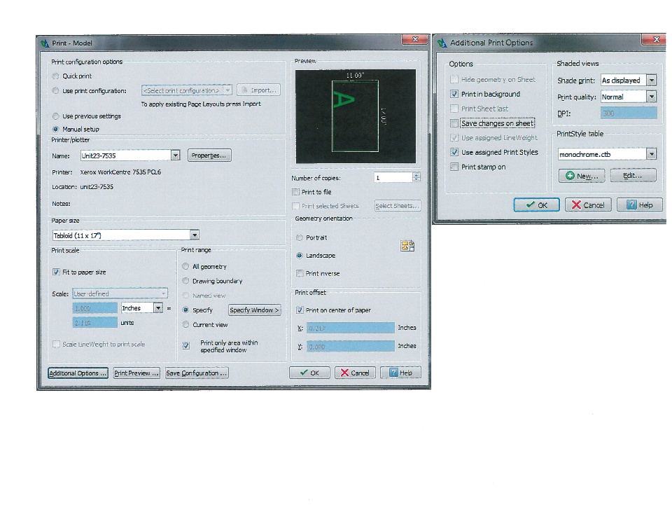

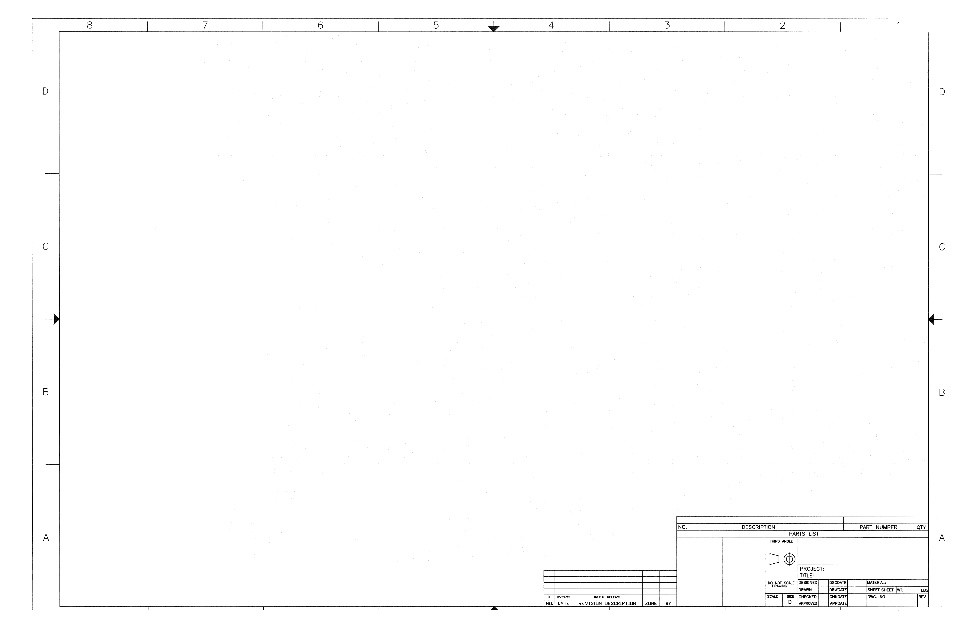

With Draft sight 2015, not able to print properly with All geometry setting, it does not print centre on page and also cuts off the bottom of the title block
This problem started with update to Draftsight 2015, Now If I print with option All geometry, the print is not center to the page, same is with window option too.
Also if some one can point out to me the option to print with the printstyle but without line weight, print without lineweight looks much cleaner.
