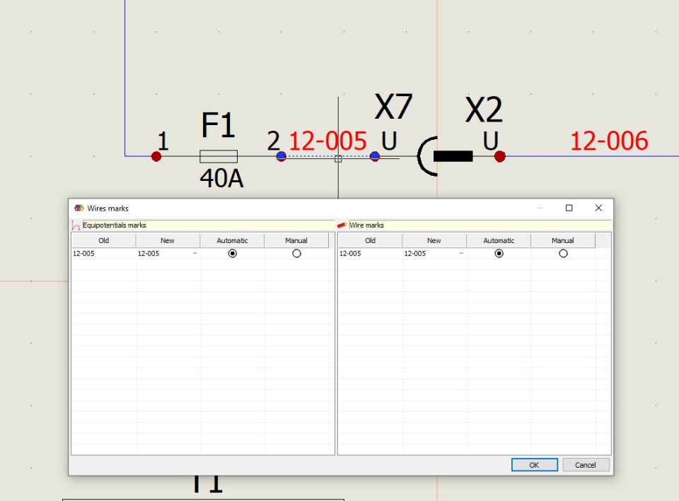

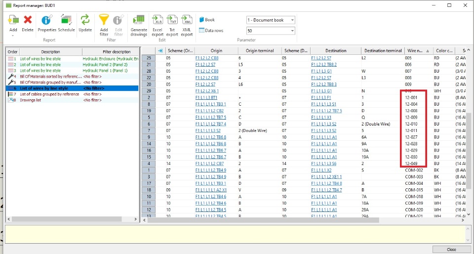

I'm having a lot of trouble getting my wire report to show all of my wires.  There seems to be absolutely no rhyme or reason some show up in the report and others don't.  If I create some location filters for the report, some wires will start showing up in the filtered report, but not in the report.
They are being named correctly with the "Renumber Wires" tool and having both Equipotential marks and Wire marks.
I'm set to "Wire" for Numbering in the Wire Styles Manager.  I have my red connection points set to "visible when connected" so I know my wires are connected to the terminals.  I'm not sure what else to try.
