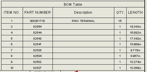

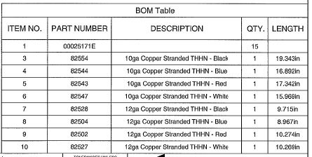

So yesterday, I created a drawing and put a BOM on it and it populates fine. Shut down, go home. Today, open the drawing and the description field doesn't populate.
I've attached the .xml for the wires. And "Yesterday" and "Today" screens of the BOM.
I noticed when I went to edit the table, the column properties were set at CUSTOM PROPERTY and DESCRIPTION. When I go to the pull down to reselect DESCRIPTION, it’s no longer there. I set it at ROUTE PROPERTY and DESCRIPTION, but that doesn’t populate the fields.
I added the DESCRIPTION to the 0002517E part and that populated in the BOM. Nice...but I can't add that field for the wires...
I'm at a loss. Help!
