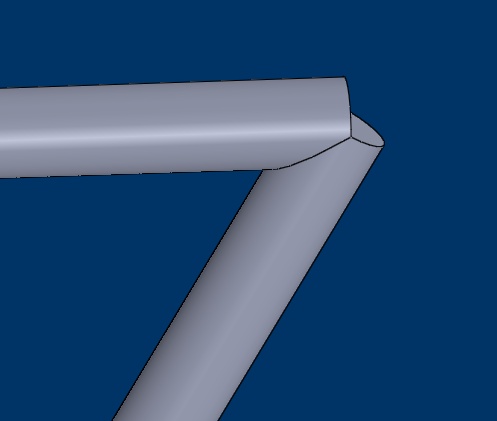

I am trying to model some parts that have wires that are bent at sharp angles.
When the wires are not bent so sharply, I can draw the complete path and then sweep a circle to get the desired result.  (See attached).
For the sharply bent wires, I get the error "Sweep resulted in topologically invalid body" when I try to sweep the whole path.
The best that I am able to do at this point is to draw one segment of the wire at a time, and sweep just that segment.  The problem is that
the resulting model ends up with a notch where the wire segments touch.  (See attached)
Does anyone have any suggestions on how I can either repair the notch or model the sharply bent wire in another way?  (I need to keep the radius of the wire that I am using, so decreasing the radius would not be a viable solution).

try putting a small radius at the corners in your path - the outside of the bent wire won't be a point in real life.

Try editing the sketch that determines your sweep path.  Use the "Sketch Fillet" function to put a radius where the wire bends.

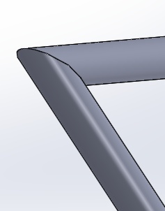

Here, like this.  Adjust the dims to suit.

     Fig 1 shows how I added the circle for the wire tangent to the path. Where the path bends is a .001 radius so that the lines are tangent. If your guide path is down the center of your wire you will never get a radius smaller than your wire radius.

Thanks for the part file.  Sorry for the newbie question, but is there a way to figure out from the part file the steps that I would need to do to draw something like that on my own?
In particular, how did you get the arc to replace the sharp bend?

You don't actually need a radius at all.  You can make it sharp and SW will sweep.  If you put a bend radius in, it will have to be at least wire radius or SW will not sweep.
42 degrees was the smallest angle I could sweep.

Basically as Glenn said, use the sketch fillet.  Draw the two lines and then start the sketch fillet command and select those two lines.  Or if they both end at a vertex, you can just select the vertex.
To look at an exisitng part, you can edit the underlying sketches and look at the relations that are put in.  This will show you the verticals, horizontals, tangents, etc.
For a part with a longer tree, you can grab the rollback bar and drag it up to the top.  Then drag it down one feature at a time to see how the model was built.
