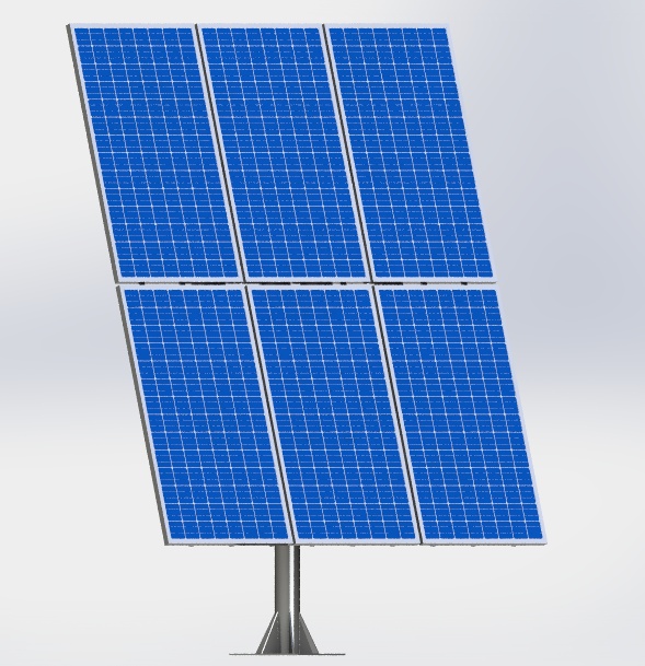

I would like to ask you about your opinion on how to perform a Fluid Flow Analysis (Fluid = Air) of a structure that I modelled in SolidWorks. I would like to investigate the effects of wind (let's say wind speed = 42 m/s [150 km/h or 95 miles/h]) on a dual axis solar tracker.

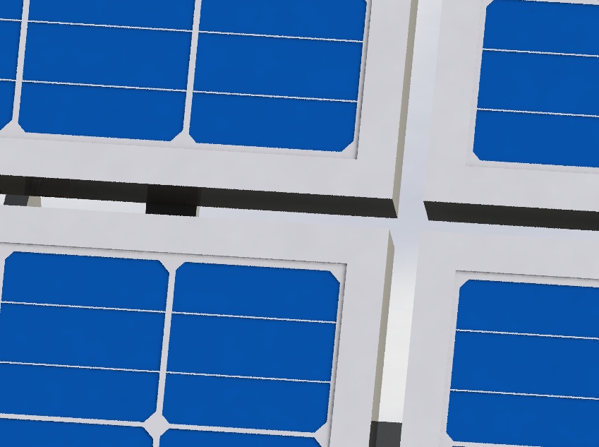

I would like to know what the pressure on the front faces of the photovoltaic modules would be when they have different inclination angles (0°, 30°, 45°, 60° and 90°) with respect to the ground. I also want to investigate what the effect would be if there is a gap (0 to 10 cm) between the PV modules, I want to see the flow trajectories around the structure and through the gaps and how they change if I use these gaps, eventually how the Drag Force and the Pressure would change by introducing these gaps.
I also want to know what the Drag Force and the Lift Force would be. Finally, I want to import the results from the Fluid Flow Analysis to SolidWorks Simulation to see how my structure would deflect and what the stress would be. I could also perform an optimisation analysis to see e.g. if I could reduce the diameter of the supporting pole (use less material = cheaper).
