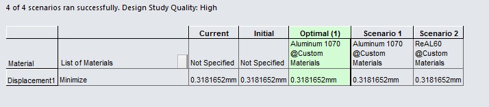

I am trying to run a design study that varies materials. Although I set two different materials with different yield strength , UTS, and Modulus I am getting the same simulation results when I try and run a design study.
When I change the material within the actual simulation, I receive the differnt results I expect. Attached is an image of my problem
