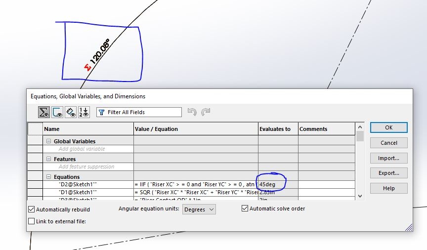

I have a macro for adding equations to a sketch dimensions. Whenever i am running the macro equations are getting created as expected. sketch dimensions also have the same equations but the dimension value is not the same as evaluated by the equations. I am trying to rebuild it but that also does not work. When after running the macro i am manually changing the equation (by multiplying some number) then it gets updated correctly.
Here is the Code -
Dim evalStatus As Long
boolstatus = Part.Extension.SelectByID2("Equations", "EQNFOLDER", 0, 0, 0, False, 0, Nothing, 0)
Set swEquationMgr = Part.GetEquationMgr()
swEquationMgr.Add2 -1, Chr(34) & Instance5 & Chr(34) & Chr(34) & Chr(61) & Chr(34) & Inst4 & Chr(34) & " *1in", True
evalStatus = swEquationMgr.EvaluateAll
