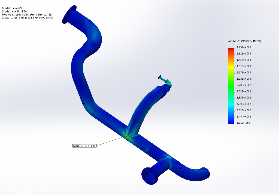

why the stress concetration/intensified so high?
as shown on the att. picture.
for Tee 20" sch.40 , 20 deg c, 1MPa, it seems the TEE needs to be rounded with enough radius. the model is built with solid elements and shell elements.
any suggestions?!
SolidworksSimulation
