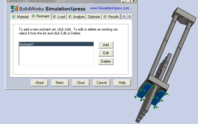

Restraint at leaf spring

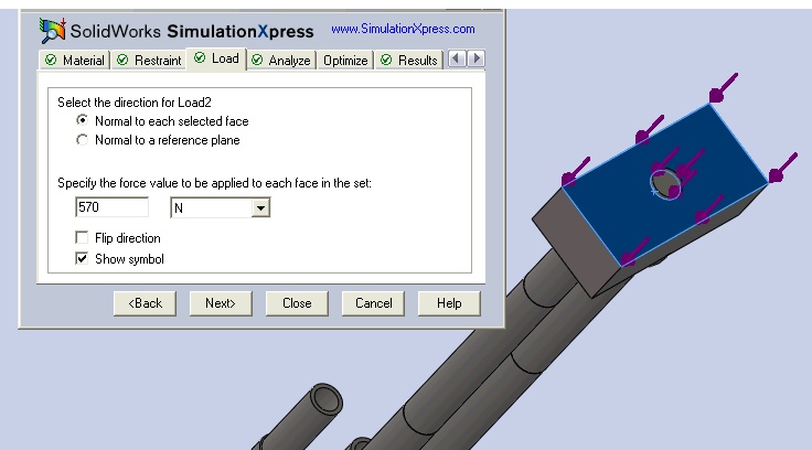

Apply 570N

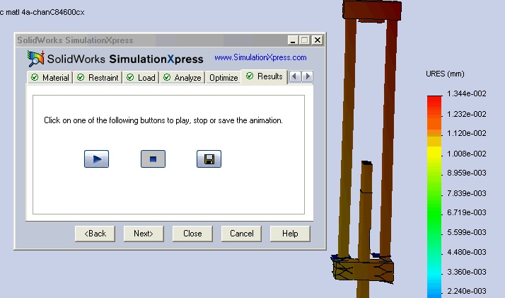

Displacement 0.0134mm downward.

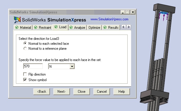

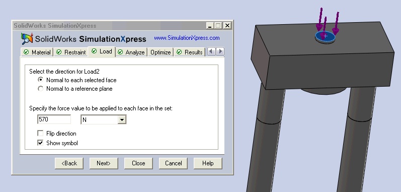

and compare below with same constraint but only change the "area" of apply force
Apply force 570N still the same.

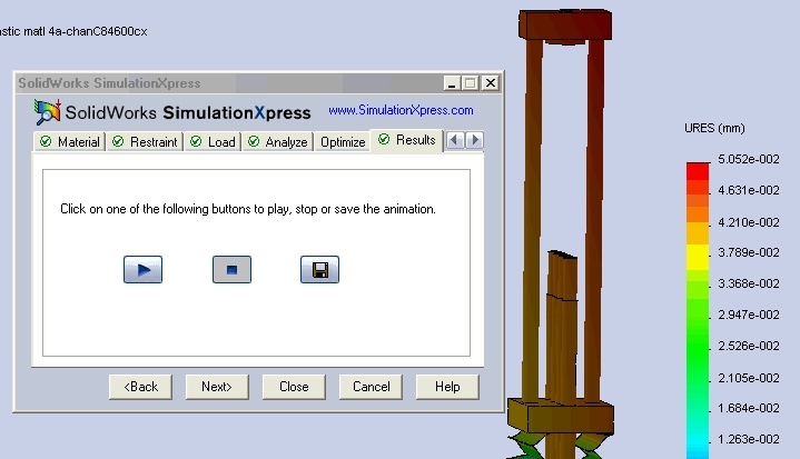

displacement 0.052mm upward.
