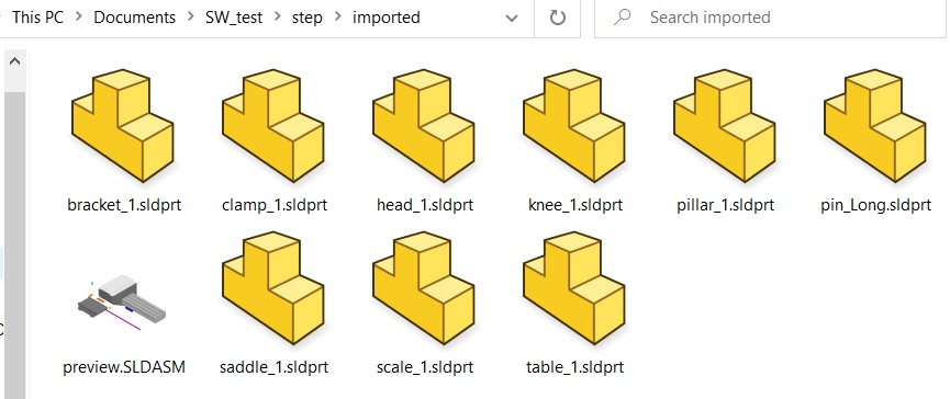

Here is an example using files from SW tutorial(SOLIDWORKS 2019\\samples\\tutorial\\assemblymates). The parts and assembly have preview thumbnails in file explorer.
But when I export it as step, import it and save them again, only the assembly has preview.

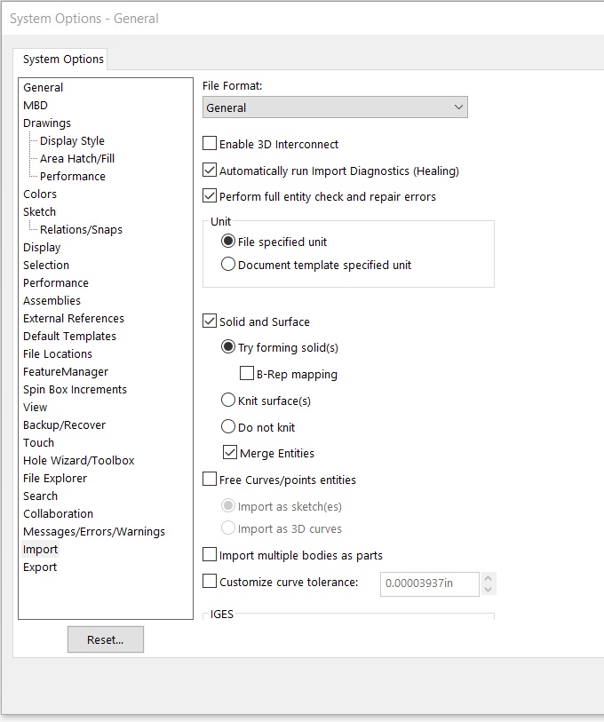

Since the original files have preview, it should not be the problem of preview setting. I think it's likely at the import settings but don't know which term affects it, so I attach my setting as well.
