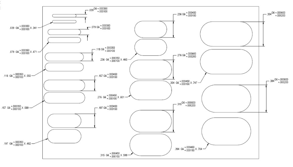

Why is there a difference in tolerance for slots made by slot sketch and line sketch
I noticed there is a difference in tolerances as the diameter of slot gets bigger. As you can see I have pairs of slots made by a simple sketch and slot sketch. At a certain diameter onwards the Fit tolerance started to be different.
It sure looks weird, any idea why is this happening?
