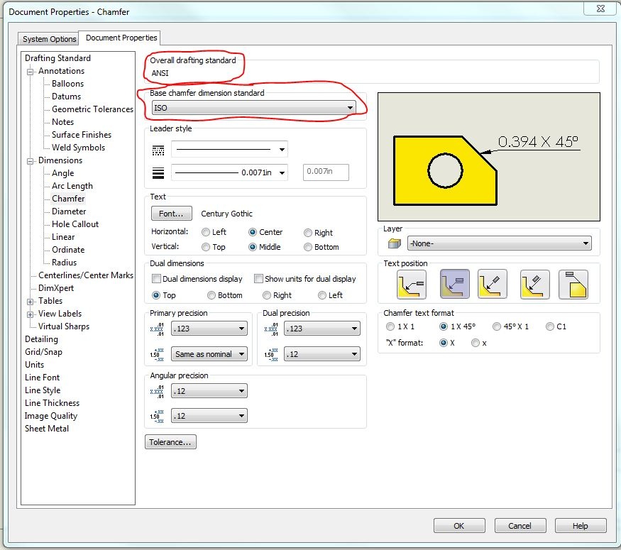

I set up my drawing template to have the overall drafting standard to be ANSI then I save the template in the corresponding location. When go to use said template though, the ballons, datums, etc. in the document properties lists ISO as the base standard. Then I change one of them, say ballons, to ANSI, and the overall drafting standard switches to ANSI-MODIFIED. After that if I select ANSI as the overall drafting standard, all of the base standards switch to ANSI.
Has anyone ever had this issue or know why it is happening?
