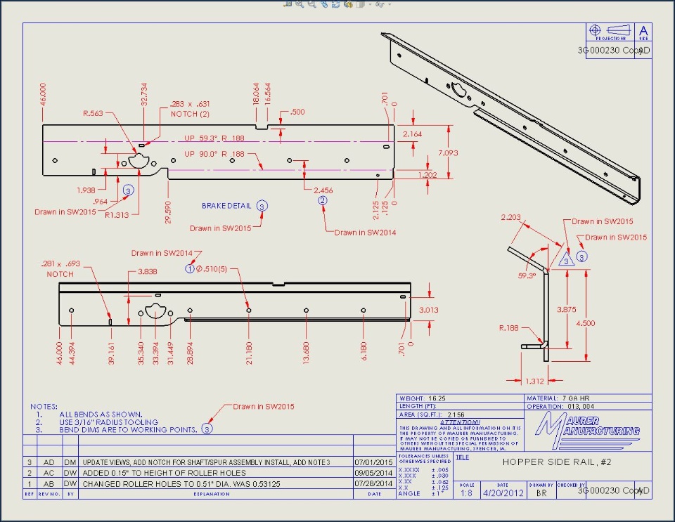

We just switched to SW2015 SP3.0 and found this issue with text not being centered in the border. We use circular and triangle border notes on our drawings to denote revisions and note call-outs. In SW2015 the text is no longer centered in the border. See the drawing below. In the circular border notes drawn in SW2014, the text is centered. The ones drawn in SW2015 are not.

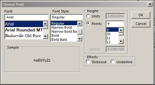

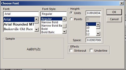

After doing some investigation I found that if I change the Document Properties/Annotation/Notes/Text Font Height from "Points" to "Units" it fixes the problem. I also noticed that with the Font Height set to Points the "Space:" is grayed out. When Units is selected, the "Space:" is not grayed out and editable. See below.
