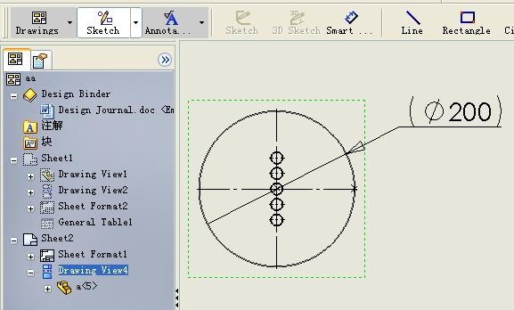

Why don't run InsertHoleTable

Private Sub ll()
   Dim SwApp As SldWorks.SldWorks, SwModel As ModelDoc2
      Set SwApp = Application.SldWorks
      Set SwModel = SwApp.ActiveDoc
   Dim SwSelMgr As SelectionMgr
      Set SwSelMgr = SwModel.SelectionManager
   Dim SwDraw As DrawingDoc, SwView As View
      Set SwDraw = SwModel
   Dim SwFeat As Feature, Ss, Pp(1), Rr
      Set SwFeat = SwDraw.FeatureByName("Drawing View10")
      SwFeat.Select True
      Set SwView = SwFeat.GetSpecificFeature2
      Debug.Print SwView.ScaleDecimal
      kk = SwView.ScaleRatio
      Ss = SwView.Position
      Rr = 300 / 2 / 1000
      Pp(0) = Ss(0) + Rr * SwView.ScaleDecimal
      Pp(1) = Ss(1)
      With SwModel.Extension
         .SelectByID2 "", "EDGE", Pp(0), Pp(1), 0, True, 0, Nothing, 0
         .SelectByID2 "", "FACE", Pp(0) + 10 * SwView.ScaleDecimal, Pp(1), 0, True, 1, Nothing, 0
      End With
      SwView.InsertHoleTable False, 0.1, 0.1, 3, "D:\\h.SldHolTbt"
      Stop
End Sub
