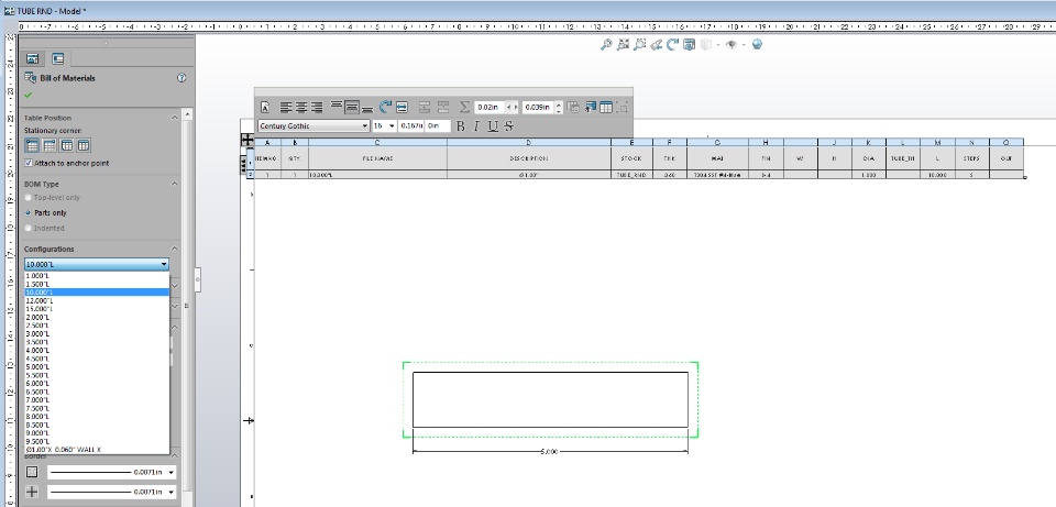

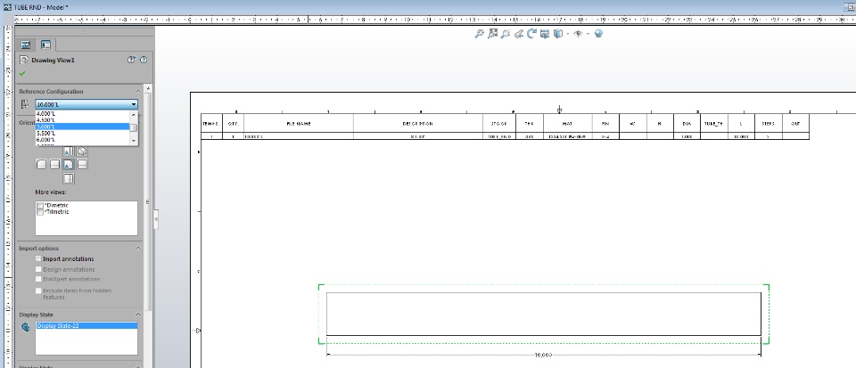

I am setting up some stock tube lengths using design tables. When I create a drawing from a configuration of the part and insert a BOM selecting the reference view, everything goes as expected. Later lets say I decide to change the reference view from a 10.000" long to a 5.000" long via configuration as seen below:
I now have a 5.000" length and the BOM does not reflect the changes, refresh, regen, force regen, etc.etc.
The only thing that works is to click on the BOM and edit the "Configurations" listed there making it a 2 task update (one for the model view, one for the BOM).
Am I missing something or is this working as intended and if so what is the logic behind it? I would appreciate some help here, it seems like the BOM is referencing the model/configuration instead of the model view which it asks for to create a link.
