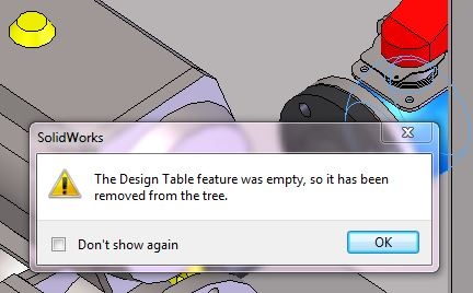

Now, every 2-3 days, I will open another part in to a route and solidworks DECIDES FOR ME
"The Design Table feature is empty, so it has been removed from the tree."
Dear SolidWorks,
Why would you give me a dialog that says "I am deleting your data and there is nothing you can do. You probably don't ever want to know that I am deleting your data in the future, Don't show again?"
Why would my design table be present last night, but when I come in today and open the exact same model, it decides to delete it?
Why does SW decide that 18 parts have changed in the model as soon as I load it, even though NOTHING was actually changed?
--> I think this is what has broken my part. Why, every time I save, does SW try to save all of my READ-ONLY flanges and elbows? (and a ton of other parts too)
--> Clearly my READ-ONLY parts' design tables are still there; do I need to make EVERYTHING READ-ONLY or else SW will delete more of my data?
