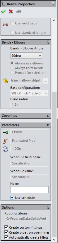

I believe either many of us using SolidWorks routing are facing this issue or I have screwed up some thing in SolidWorks.
When I start a route, with standard SolidWorks library routing pipe (say 1 inch,Sch 40 pipe) and try to drop a fitting (say a tee) SolidWorks pops up the Configuration selection window, populating all configurations for the selected route diameter (Sch 10, Sch 40, Sch 80, Sch 160). So why does SolidWorks don't filter routing components with Schedule values ?
I had even tried to change the "Default" templet, asking to mandate use of Schedule value & while routing also I had selected "Use Schedule", still it does not work, refer below attached images
Kindly provide some support
