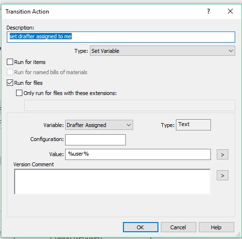

We are in the process of setting up our new PDM Vault and were trying to get a variable "Drafter Assigned" to Default to the current user in a search card. The variable is being written with the default %user% command as it reaches a new document state in the workflow.

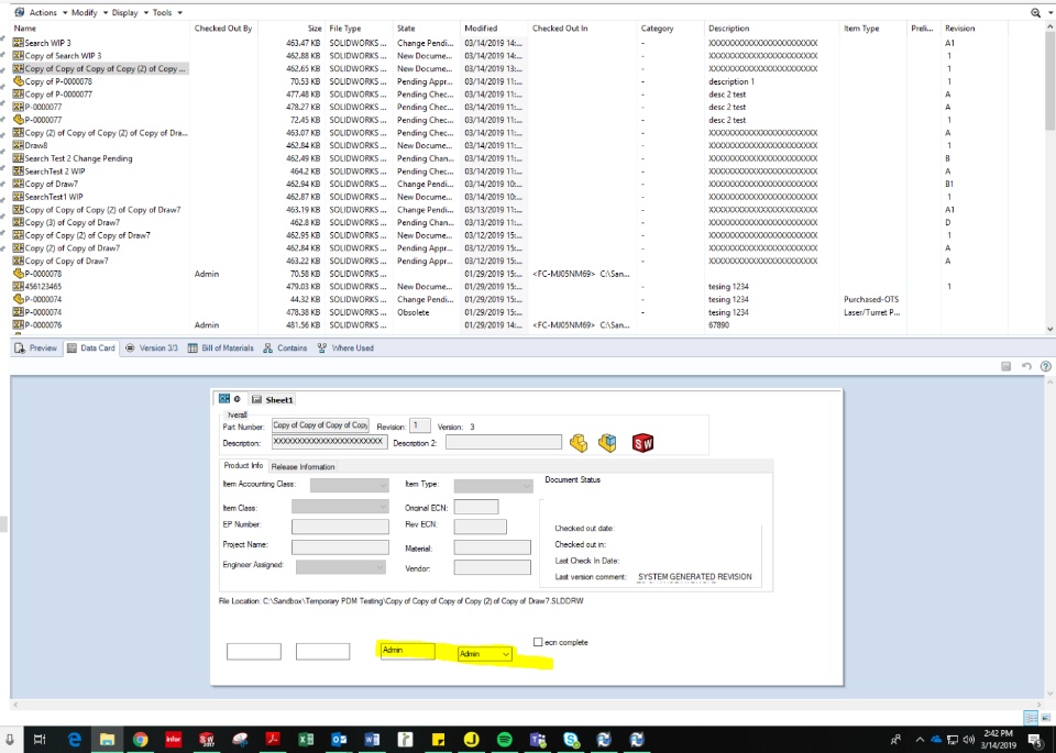

The action works as it shows up on the file card.

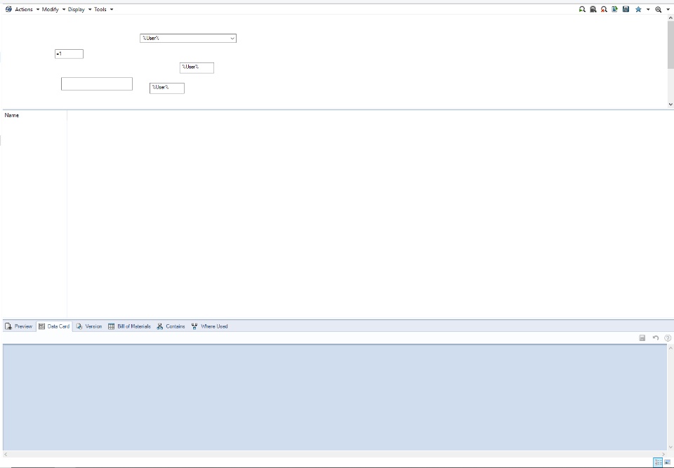

But when attempting to create a search card for this particular variable,

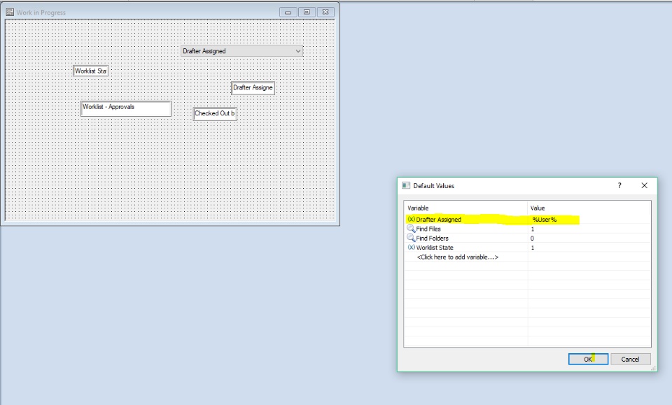

the picture below is what is shown as the default value. Are we missing something or supposed to be doing something different to default the current user to this variable? We have tried both %user% and %User%.
Is there a different way to set a default value of the current user in a search card?
