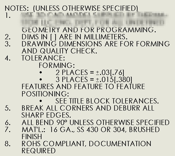

I have some VBA code that I'm using to find the tolerance values in a non-custom-property-linked tolerance note on drawings I'm converting title blocks on. The problem is that it seems like the code destroys some kinds of formats in various notes as it's searching for the text string.
Here is the main offender before and after running the macro:
Here's the code. It's messy and a part of a larger module but I think this should run on its own.
