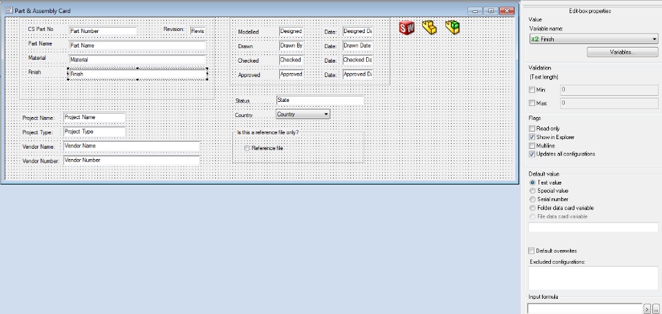

A bit new to the data card/custom property tabs side of EPDM.

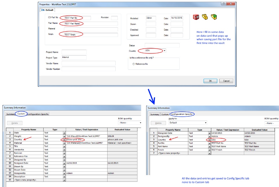

When we save a new part into the vault, its data card pops up. We enter data into the required fields. It then puts that data into the Configuration Specific tab of the part file, instead of the Custom tab of the part file's custom properties
Does anybody know why?
And how to get them to go into the Custom tab instead?
