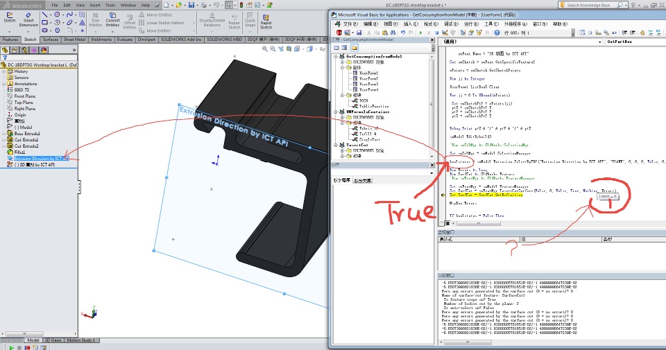

Hi Guys,
Why could not add this insertCutSurface feature ? as the below picture shows, the macro has already select a plane, then why the insertCutSurface showed the errors=0 , means no error , but cut no solid ?
| swSurfaceCutFeatureError_BodiesNotSpecified | 1 = No bodies specified to cut |
| swSurfaceCutFeatureError_InvalidVariant | 2 = Array passed to IFeatureManager::InsertCutSurface must contain only body objects |
| swSurfaceCutFeatureError_NoError | 0 = No error |
