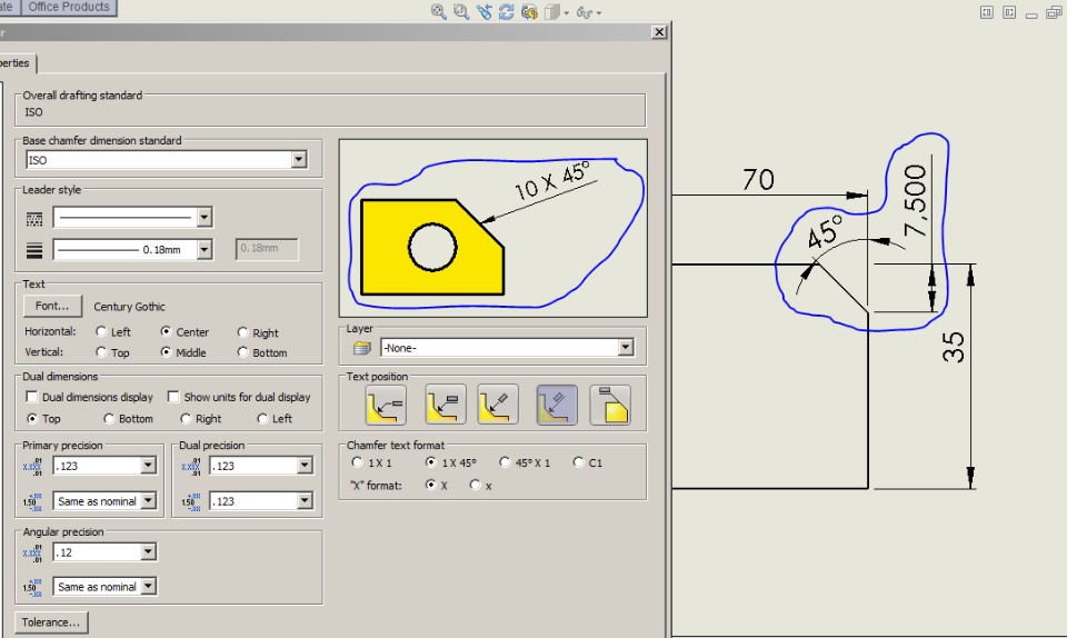

Hi all,
As you can see from the image attached, I havent changed any of the ISO drawing standards for chamfers in the document settings. Yet, when I create a drawing and execute "Model Items..." the dimensions that describe the chamfer are not as I expected them to be. Manually selecting the feature also produces the same undesired dimensions. This is not a one time thing, in all my documents with chamfers, they appear as length and angle in two seperate dimensions rather than a single dimension describing length and angle.
Any advice is much appreciated, thanks!
