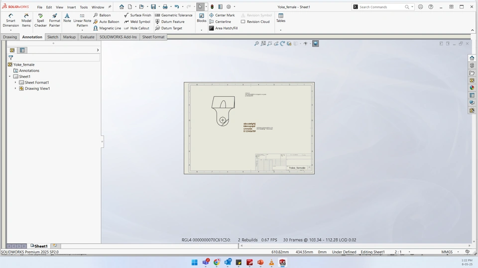

I was trying to have the best font display in my drawings. aside from anti-aliasing, which settings affect the font's look?

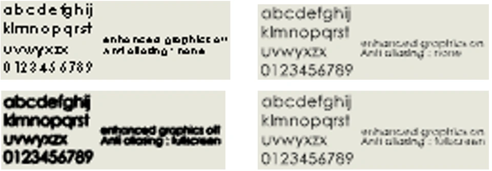

Here's a simple check that I've done - took 4 images of the following picture, in 4 scenarios: Anti aliasing on\\off, and Enhanced Graphics Performance on\\off. the screen resolution is 1920 by 1080.
taking the 4 pictures and zooming , I got the 4 following pictures would I believe some will find useful:
I find that turning both settings on would produce the best results so far. Although it seems I got an answer, it makes me wonder - Which other settings allow us to control the font display? One would assume that 'Enhanced graphics Performance' won't affect the graphics, but it does.
