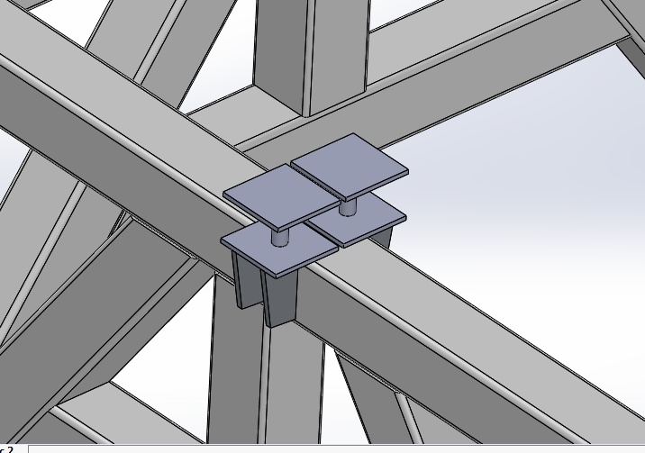

Same model.

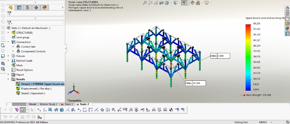

force applied is 2354400N, material-MS

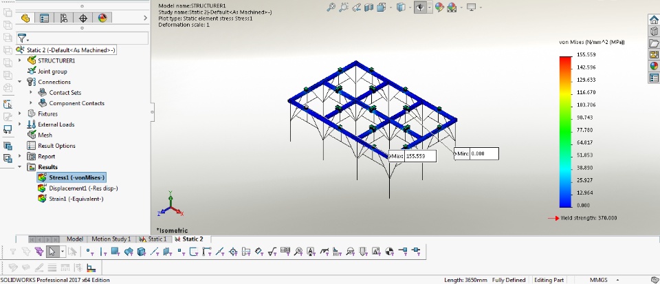

case-1 made part model using structural member-simulated it-got results.

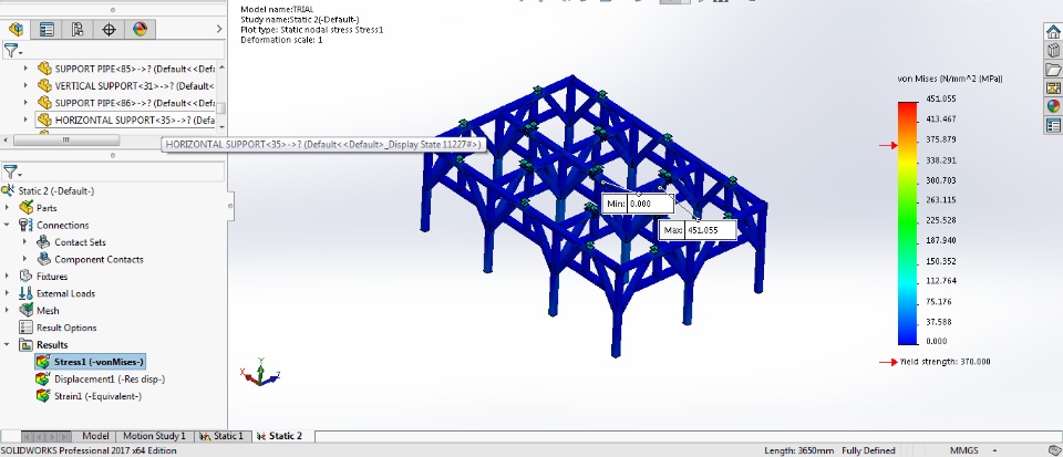

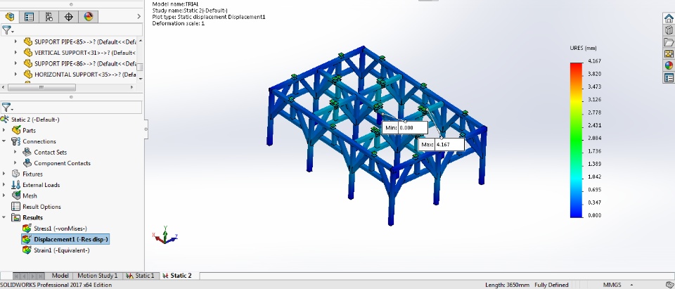

case-2 made same model using parts in assembly- simulated it- got result
question- which case is prefered for the desired result if want to find displacement and stress?
                which result to be considered in case-1, upper bending or von mises
