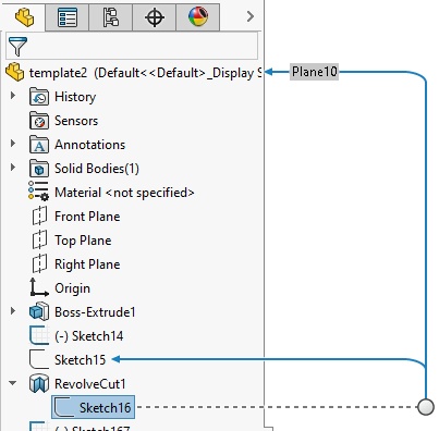

I received a part file with some revolve features in which I will be writing solidworks automation for in C# but I'm running into an issue. Each sketch of a revolve feature is created on its own plane, but none are visible in the design tree. The only visible planes are the Front, Top, and Right. If I select one of the sketches, it shows the Plane is the root of the part. Where is the plane feature? Hide/Show planes is turned on. I searched everywhere I could think of. I even wrote a macro to analyze the selected sketch and plane data and it states the plane is visible, but as the image shows, they are not. What am I missing here?
Macro
Private Sub CheckSketchPlane()
Dim swApp As SldWorks.SldWorks
Dim swModel As SldWorks.ModelDoc2
Dim swSelMgr As SldWorks.SelectionMgr
Dim swSketchPlane As SldWorks.RefPlane
Dim swSketchFeat As SldWorks.Feature
Dim swPlaneFeat As SldWorks.Feature
Dim swSketch As SldWorks.Sketch
Set swModel = swApp.ActiveDoc
Set swSelMgr = swModel.SelectionManager
Set swSketchFeat = swSelMgr.GetSelectedObject6(1, -1)
Set swSketch = swSketchFeat.GetSpecificFeature2
Set swSketchPlane = swSketch.GetReferenceEntity(longstatus)
Set swPlaneFeat = swSketchPlane
Debug.Print "Reference Entity: " & longstatus
Debug.Print "Type: " & swSelMgr.GetSelectedObjectType3(1, -1)
Debug.Print "Type Name: " & swPlaneFeat.GetTypeName2
Debug.Print "Feat Name: " & swPlaneFeat.Name
Debug.Print "Visible: " & swPlaneFeat.Visible
End Sub
Immediate
Reference Entity: 4
Type: 9
Type Name: RefPlane
Feat Name: Plane10
Visible: 1
