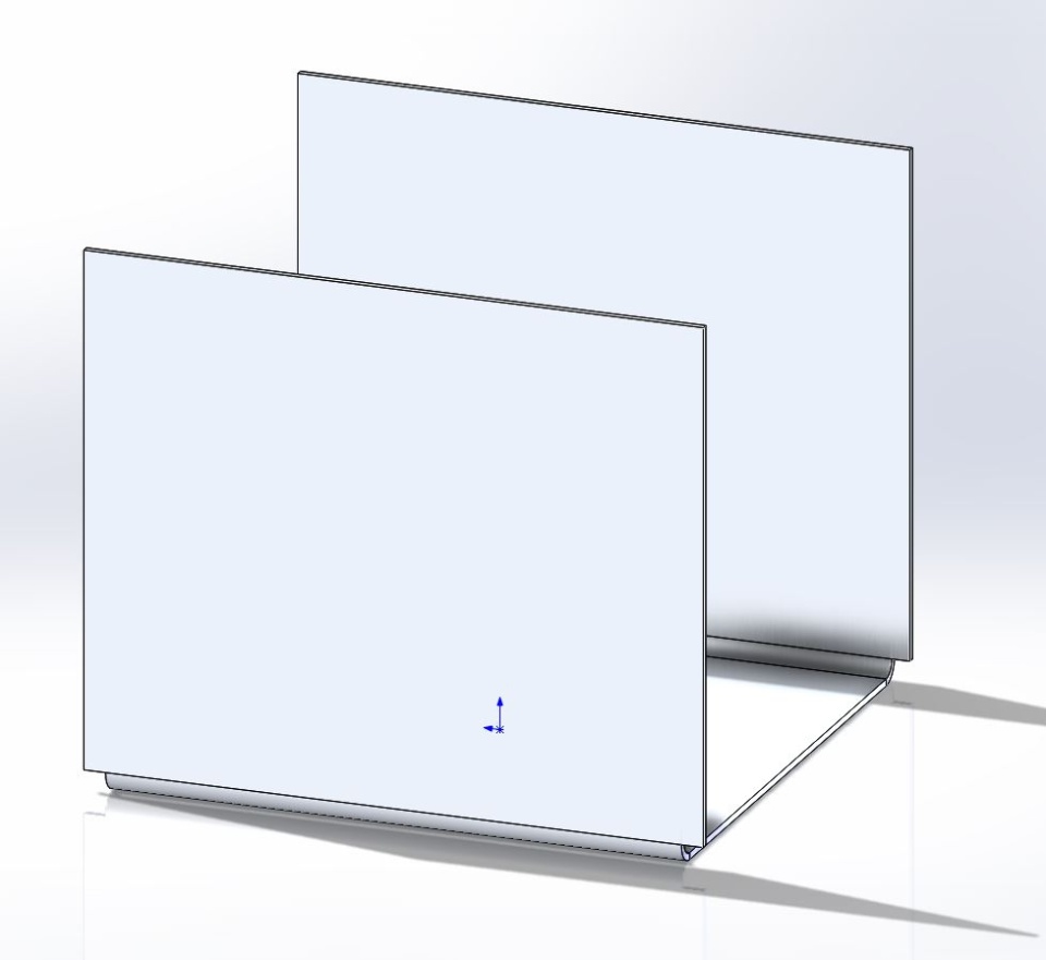

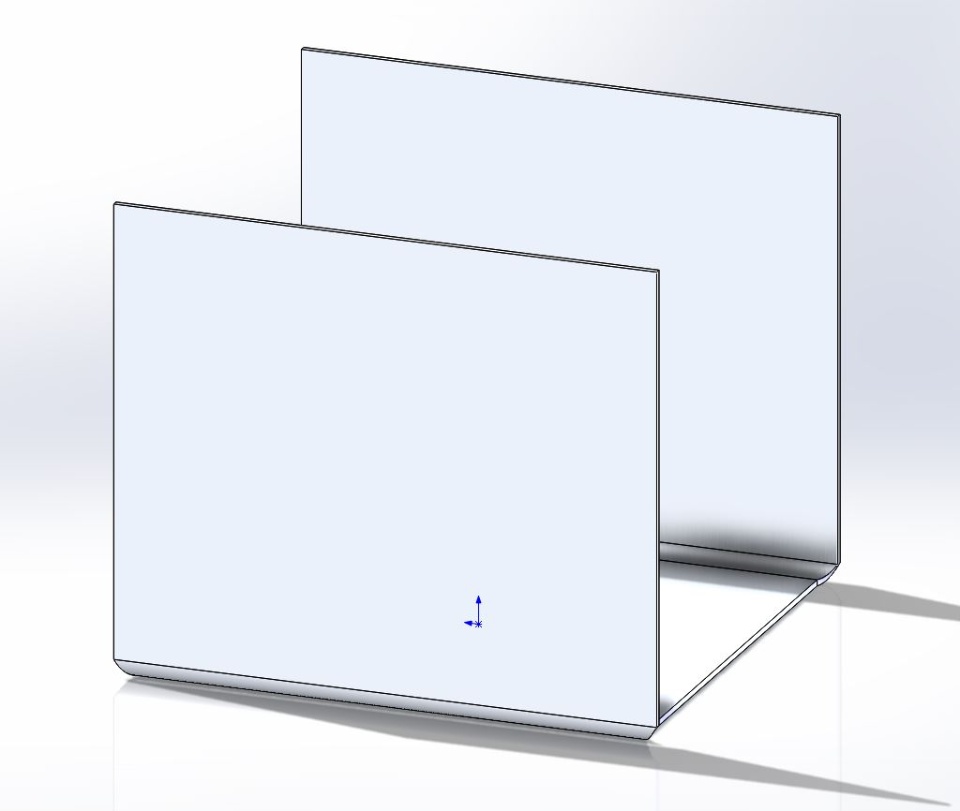

SolidWorks keeps removing the smooth transition between the base flange and the edge flanges of this part and adding notches. The notches only appear in the flat pattern or when I edit the edge flanges and click the green check without making any changes. Any ideas on how to prevent the notches? The offending file is attached.
