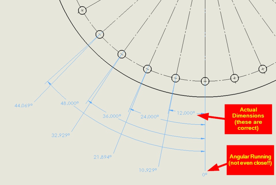

OK, so I have a colleague here who tried to place some angular running dimensions on his drawing. The dimensions were not correct. In some cases, not even close! This isn't just an issue with rounding error, I can show a dimension that is off by almost 4 degrees!
As I go farther around the circle, the error gets bigger and bigger.
I have attached my (SW 2017) test model and drawing. But what the heck is going on?
