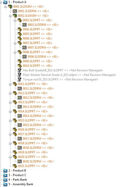

Option 1
Use Parts and assemblies in there original "first" assemblies, and then any assemblies using these parts or sub assemblies then look at the first instance.

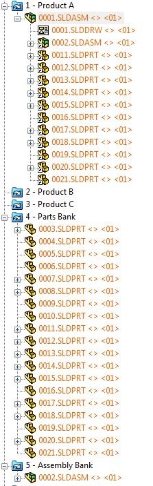

Option 2
All parts and sub assemblies are located in Parts, and sub assembly banks. and both (or more) aseemblies would then Shortcut to the parts bank.
