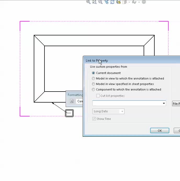

I have been trying to put weldment cut list properties into my SolidWorks sheet format via a macro.  I was able to find something from another post that mostly works but I am having issues with it.  I am not very experienced in SolidWorks macros so the syntax is new to me.  Below is what I have.  The bolded area is where the program crashes.  It works most of the time, but if I try to have it get properties from a pipe it doesn't work.  Any ideas why?  I think its something to do with the getBodies function but I am not sure what to do about it.
