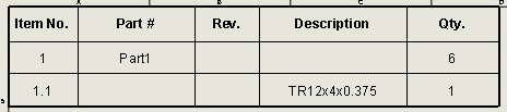

When I did the indented BOM with the Detailed Cut List selected I got this:

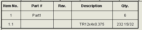

When I deselected the Detailed Cut List I got the length of one of the weldment parts in the configuration (which is an issue in itself because the As Machined configuration has the part being bent while the As Welded configuration does not).

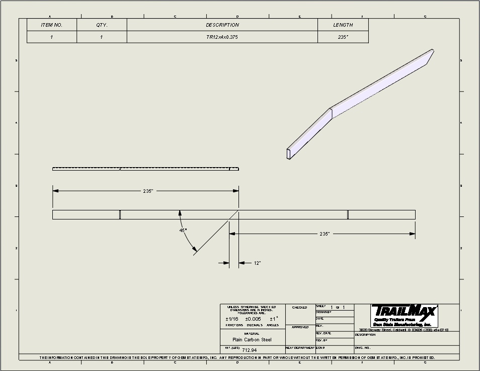

Taking it a step further, the drawing below is a rough representation of the part I have in mind. One end of the part has a 45 degree cut, so we utilize that cut as a common cut to save almost a foot of the material as shown. Is there any way the have SolidWorks also recognize that ability?
