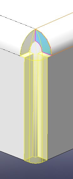

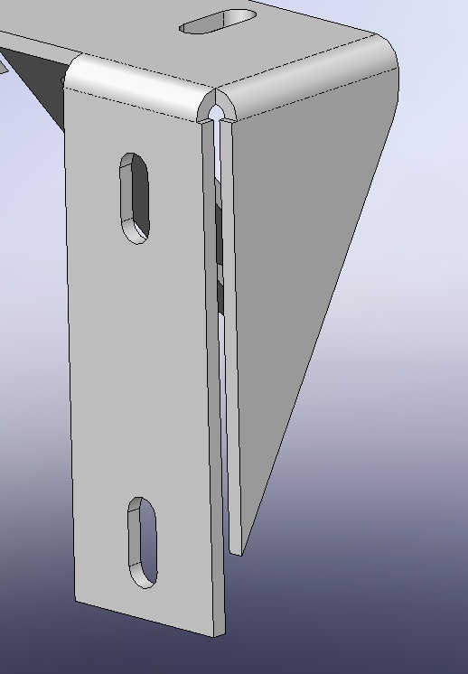

I have a part that I want the corners closed within .0625", corner to corner with an open bend region, to give the welder a closer butt joint to weld (it has to be like this so the drawing \\ flat pattern is correct). The Sheet Metal weld corner doesn't work when the flange is not colinear to the opposing flange. However, if I remove the closed corner it lays the weld in just fine (now the drawing \\ flat pattern incorrect). None of that makes sense to me, because in the real world this very doable operation.
Closed Corner, Weld corner will not work:
Welded Corner, minus the closed corner.
Example file: Closed corner with a welded corner.
Does anyone have a good answer as to why SW does not allow this functionality?
