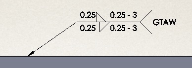

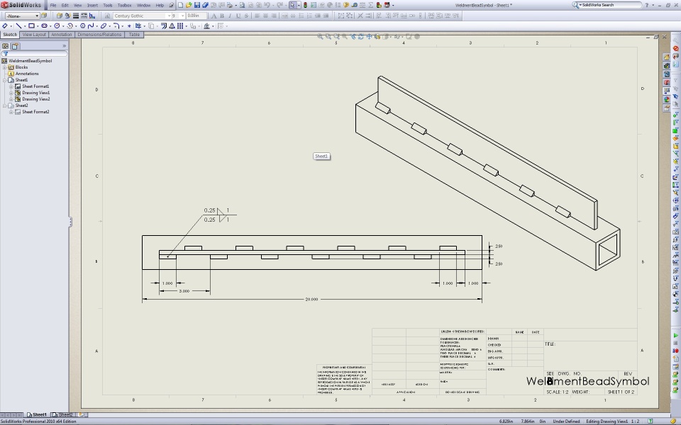

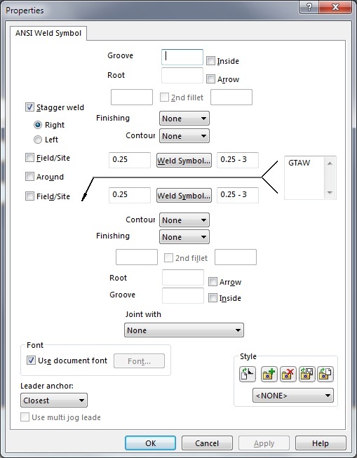

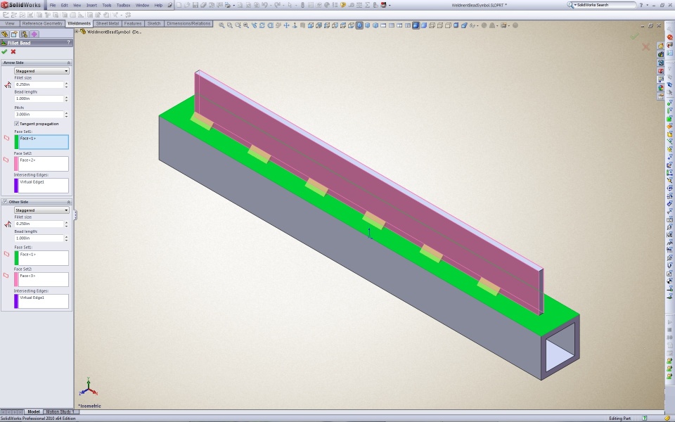

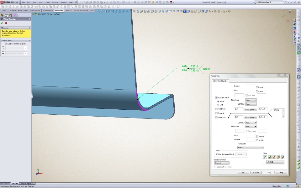

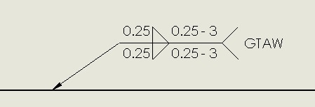

Hi all,
I am having an issue with an imported weld symbol. please see attached. It brings in the size, but the spacing of 3.00 is not present. thoughts? i dont see any settings that would control this. thanks in advance!
Tony
