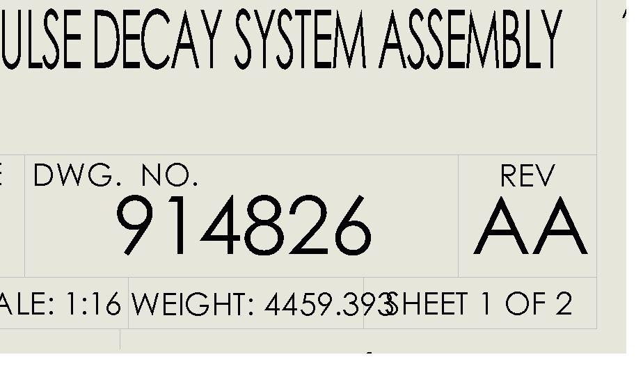

I have a weight/mass that is documented on all of our drawings that is derived from
""SW-Mass@\\\$PRP@filename.SLD***"
via this placeholder in the drawing format
WEIGHT: \\\$PRP:"Weight"\\\$PRPSHEET:"Weight"
That points to a property in the part/assembly
"SW-Mass@filename.SLD***

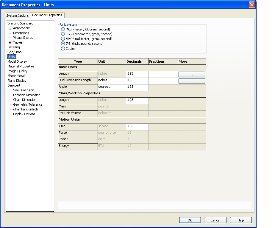

The problem is it shows up as a three place decimal number and when I select
model/assembly tools/options/document properties/units
the Decimals field for Mass is not selectable.
Ultimately I just want the weight on the drawing to show a rounded whole number.
How do I alter the decimal to do so?
