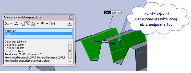

Hi Guys,
I just wanted to touch base and see if anyone has any comments or questions on the Measure Tool project which is part of the Week 1 beta focus.  The key improvements for testing would be the new “point to point” mode which allows you to measure between any location selected on sketch entities, edges, faces, etc.   Once a point-to-point measurement is made, these endpoint are also drag-able so you can dynamically check measurements as you drag the measurement line endpoint.    Refer to the "Tools-Measure" menu item…

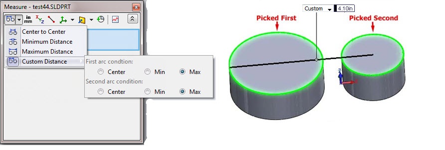

Another focal area for testing and for any comments would be the new "History" window which can be accessed with the 7th toolbar button seen below, along with the new "Custom Distance" option for arc measurements.
