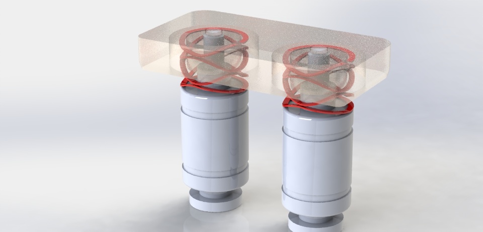

Hello everyone,
I'm deligthed to share this part, that makes a Wave spring.
There's also a macro that does the job. The macro provides a nice interface, so don't need to go through the awful Equations Tab.
Highlighted in yellow, are the values that can be changed. Notice that the number of waves per turn should always be multiple of 0.5, (1.5, 2.5, 3.5, ....),
Part has been updated, now calculates the total height. Message was edited by: Marcos Rodríguez
Message was edited by: Marcos Rodríguez Macro uploaded
Message was edited by: Marcos Rodríguez macro working fine now, adds Upper and Lower planes and an axis, for location into an assembly.
Message was edited by: Marcos Rodríguez Some bugs fixed in the macro
Message was edited by: Marcos RodríguezSome Equations were incompleted in the macro, and Chr(13) not always worked.
