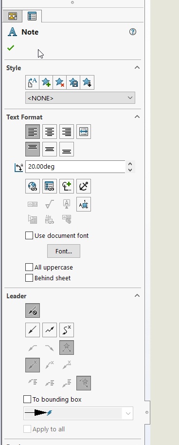

WellI recorded a macro to make a Water mark on my Drawings for Preliminary Drawings. THe Font does not set to the correct size (Should be 72 points), also doesn't seem to have the Behind sheet check mark set as well. here is my Macro

here is the settings even when i set the Behind Sheet check box the recorded macro doesn't seem to capture it!

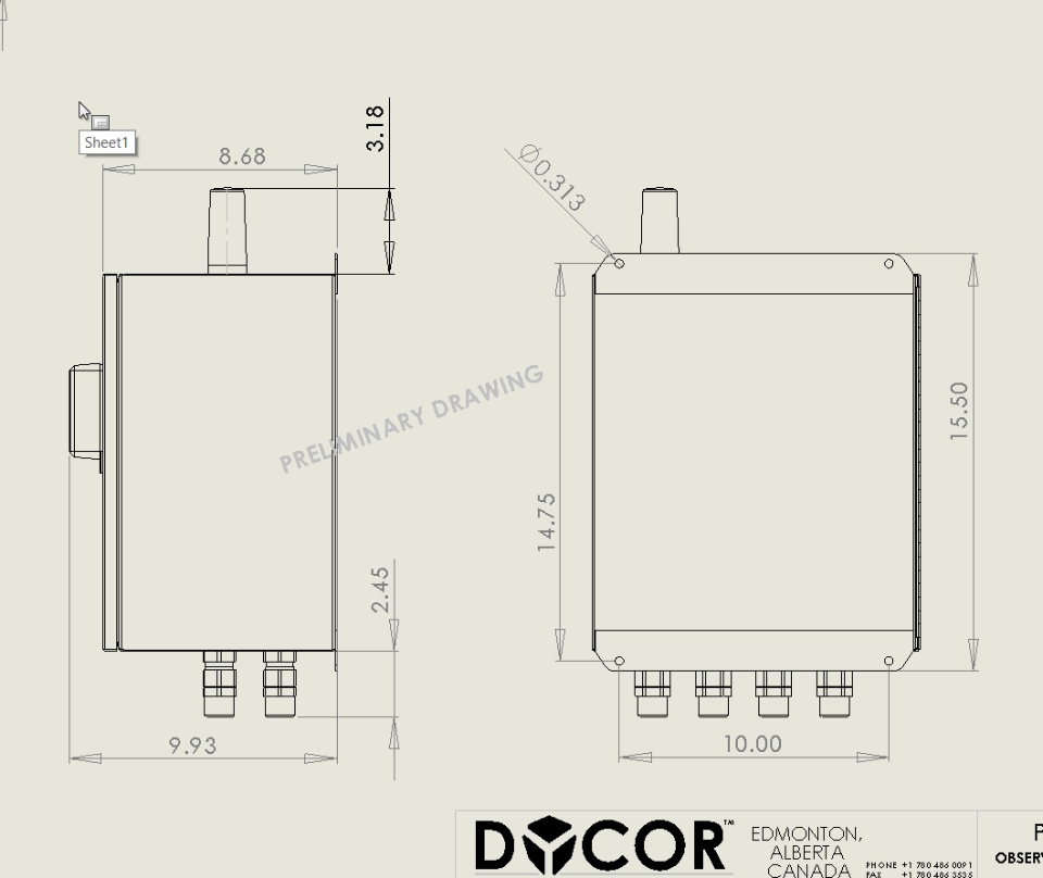

Result, Font should be very big!
