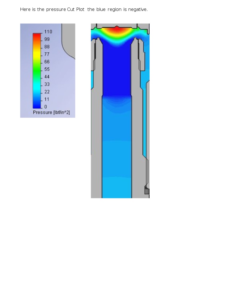

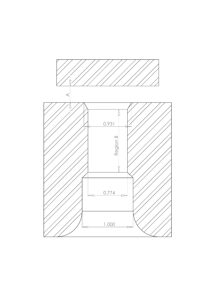

My team is currently running silumations on safety valves and have hit a snagg.  We are basically running a simulation on a water jet hitting a wall.  Look at attached pdf named example(these are test values not real ones).  We have it set up with Pressure at the Inlet and Pressure at the outlet  As long as Dimension A is around .100 " the everything looks good, but when we increase A, region B gets a negative pressure and velocity out increases drastically.  any advise on solving this would be helpful.SolidworksFlow Simulation

Hello James,
What happens if you set a flow rate (mass or volume) on the inlet, along with a pressure at the outlet?
Cheers, Rich.

SF 2009-09-01
Hello James,
can you post more details, such as the actual pressures you are applying at inlet and outlet?
Also, post screenshots of your computational domain, and perhaps a cut plot or three?  Trajectories perhaps?
Also include your version, such as SW2009 SP2.1, or whatever.
Thanks,  Rich.
SF
SF 2009-09-01
Inlet Pressure       100 psi
Outlet Pressure     14.7 psi
I will get you some pic's soon
SW2009 sp4.0

SF 2009-09-02
Hi,
Maybe there is some cavitation??
If you check "cavitation" option you should not get negative values any more and see if cavitation area is important or not.
SF
SF 2009-09-02
Thanks,
that seems to have solve the problem.
