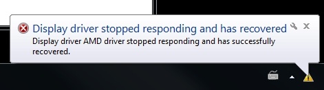

Is anyone else having issues with the certified FirePro W7000 divers? I am using 13.152.4 and card will work fine up until a slightly heavy workload and then it will stop and pop up a message saying “Display driver stopped responding and has recovered”…but SW stays frozen.
My system is homebuilt
Motherboard: ASUS X97 Deluxe LGA 2011 Intel X79
CPU: Intel Core i7-4930K Ivy Bridge-E 3.4GHz
OS: Windows 7 Pro x64
The SW support/videocardtesting certified drivers are 13.152.4 and 9.003.03. I’ve tried both with no luck. Any suggestions on what I should do? Thanks in advance!
