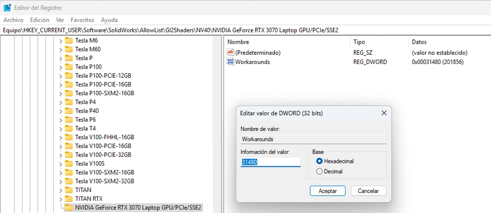

Does anyone know why the view settings is grayed out?
My graphics card is "NVIDIA GeForce RTX 3070 Laptop GPU/PCIe/SSE2". I have tried to manually insert it into the corresponding Windows Registry as shown, but the problem persists:

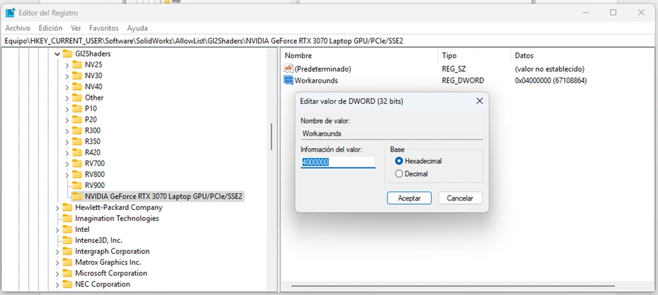

EDIT:
It seems I made it work by creating the folder in another path and another value for the workarounds key:

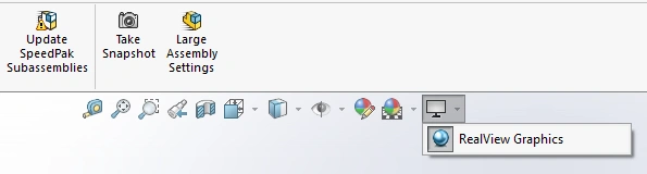

Still, options like perspective mode or shadows are not visible:

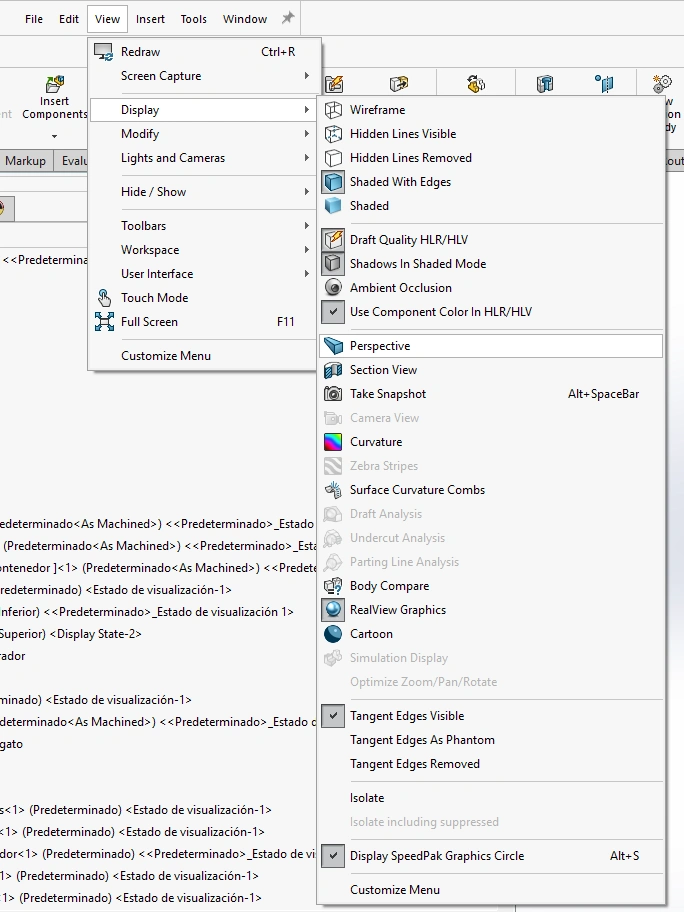

They do appear, nonetheless, in view-display:
