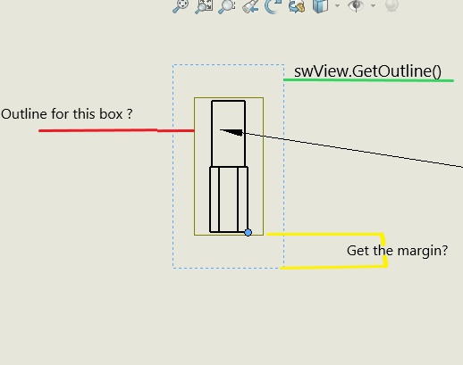

I would like to get the outline for the inner rectangle show in the diagram. The swView.getOutline gives the rectangle that is much bigger than the original view.
as shown below.

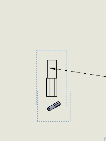

I am working on the app to detect if the view overlaps or not. If we use the view outlines to detect if the views overlap or not is not always correct.
as shown below.
