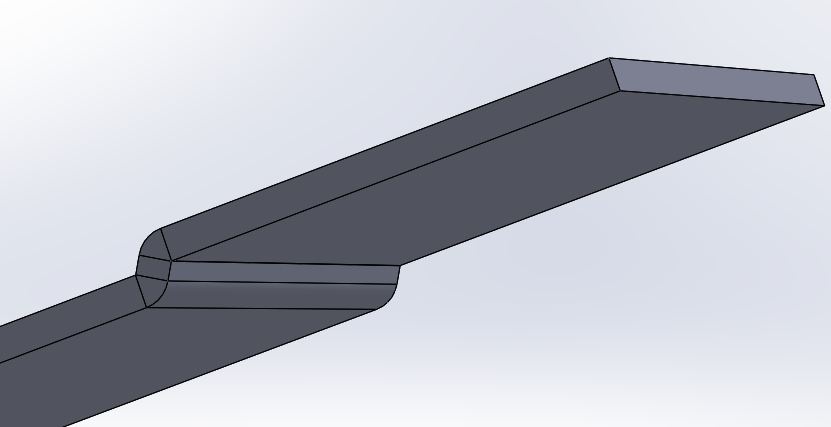

I need to make two sheetmetal parts that should connect to each other with the common up surface flushed.

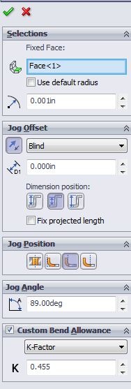

Im trying using a Jog, with a minimun blind and offset.
The material will be aluminum, 0.090"
I cannot get it right,,  I read everywhere, and people advise to make the Radius at least the thick of the material, bend radius, etc,, but when I do I cannot get the two parts meet 'flush' on the assembly.
Below is a setting of what I can get with the minimun bend radius, etc,, and my parameters for the Jog.
Id like to know if this is the right strategy for making two pieces mate this way, and what you guys advise.

The part is:
The assembly should look something like this:
These are my settings:
