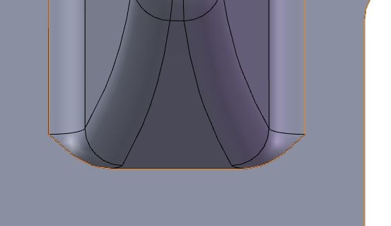

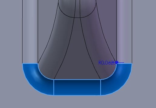

Has anyone ran into this before? Sorry, I can't share the part. As you can see, if I drag the Boss-Extrude70 to before Fillet265 it won't fail. Lower pics show the fillet itself (before and after adding fillet).
